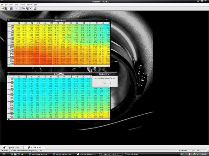

and if i try to use the 2.5 version of turbo edit this is what i get when I try to open ecu control even though u can see I have a bin open already

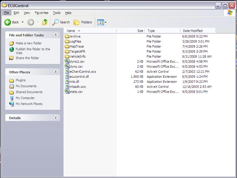

make sure you have ecucontrol 5.8.41 installed (you dont have to use it)...and make sure you have all the support files in the same folder as ecucontrol.dll.
i believe if echartcontrol.ocx isnt in the same folder or in the system32 folder...it more than likely wont open. let me know if all the included files are in the correct folder...and if it still wont work.
also look here...
http://forum.pgmfi.org/viewtopic.php?f=56&t=18836&p=117292

thanks man that did the trick 8)

thats the screenshot i was hoping for! :D

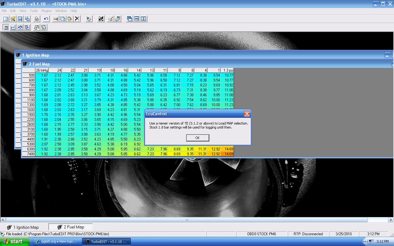

I noticed that in your screenshot of the plugin file folder, you have a lot more items and folders that do not exist in mine. I extracted all files from the compressed folders to the same folder under Plugins, installed, then loaded the plugin.
Here is a screen shot that I get when I click to open ecucontrol from within TE.
NOTE* I do not have the laptop connected to the car. Is this a requirement in order to open EcuControl? I did not think it was; I am trying to familiarize myself with the program a bit before attempting a tune.

thats because you have a stock rom open...no support for datalogging on that. try using an ng rom then open ecucontrol...it should work then.
i will add some error handling stuff for that so you at least know whats going on...

I finally got it to open. I had to reload the plugin after I opened an ng rom apparantly.
