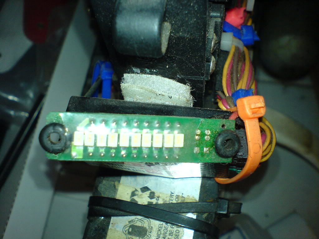

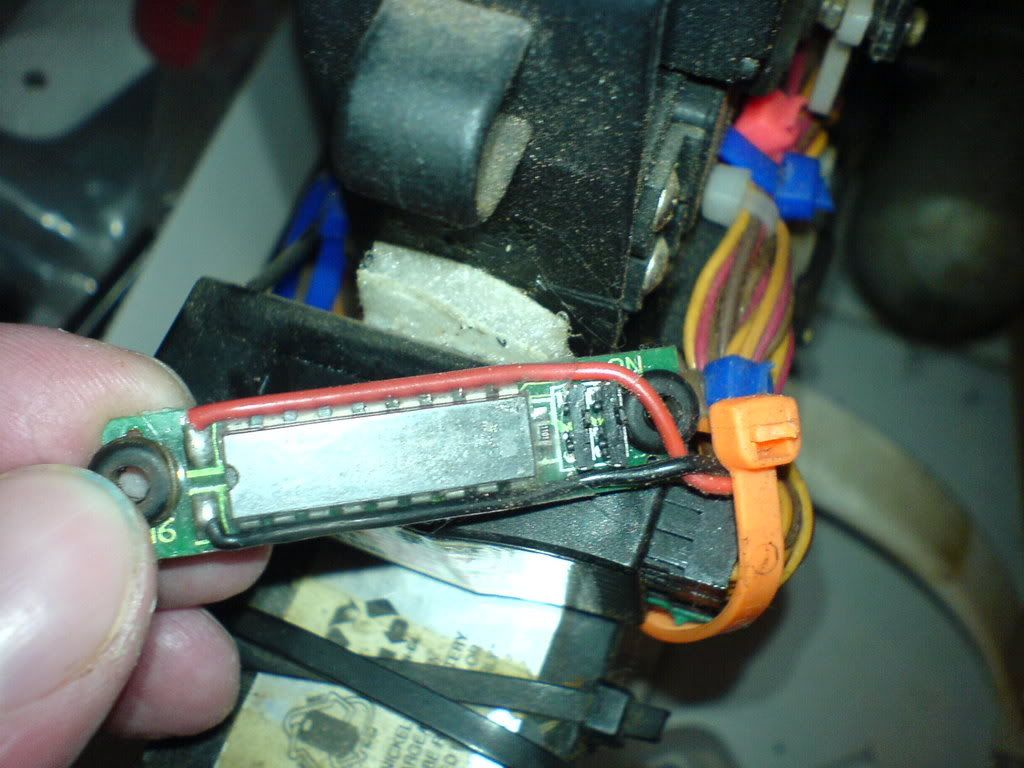

I was looking through some of my RC heli stuff and saw a battery led meter..
I dont remember where the manual to it went (it has 2 switches on it to set voltage ranges for the 3 colors on the bar). Ill play around with it and post up some pics. If anyone does find one im still interested tho..
This should fit in there..

I can't read the p/n on the battery meter pics... but that looks bang-on to what I was referencing to..
That IC is readily available, possibly even locally to you.
figure out the resistors and bam, you're in business.

I did search around and found one that can be made for under 20 bucks, but hey this one is pre built and I think it cost me like 5 bucks (cant find the exact one)
this is the closest thing I could find to it online.

just to follow up on this....
Get this little bugger and read page 2 in this PDF
http://www.national.com/ds/LM/LM3914.pdf
