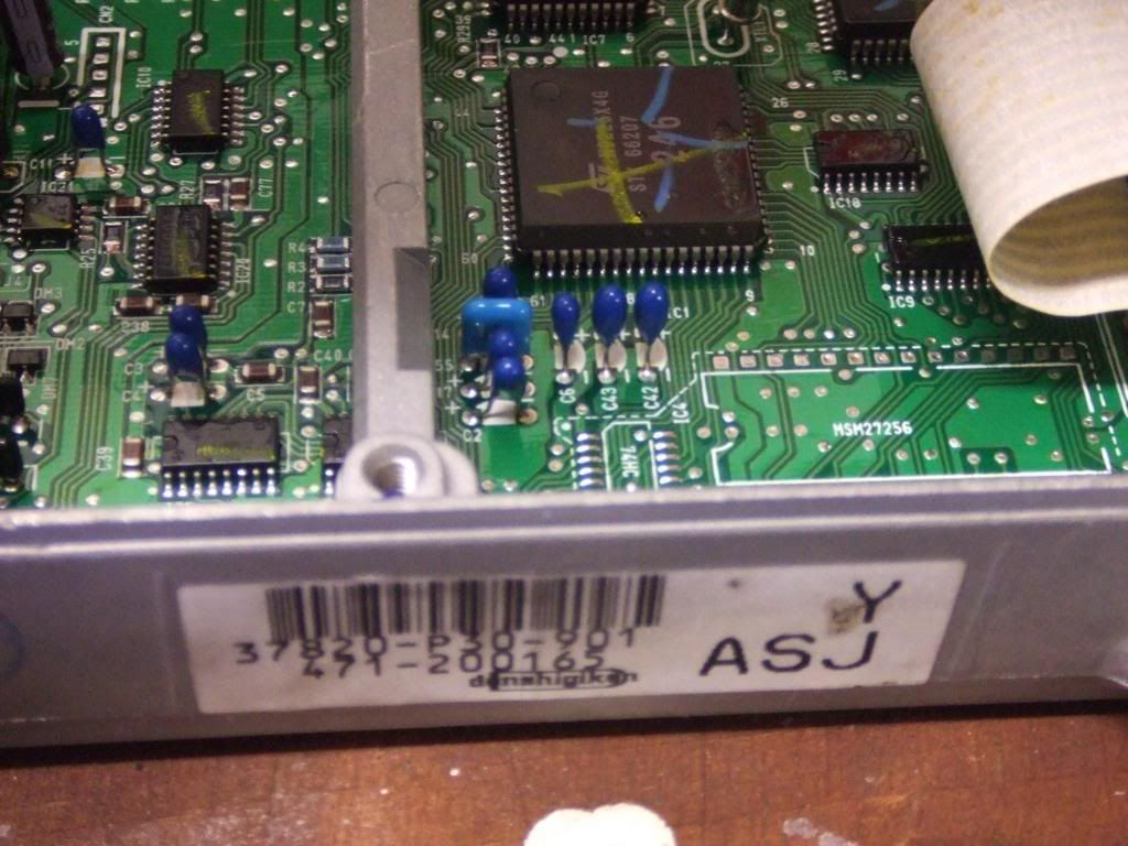

I just bought a JDM Auto P30 ECU a P30-901 (I used to have a P30-900 i dunno what the difference is here)
anyways it doesn't come with a latch chip like the wiki says that A/T ones do
Also some said that the A/T JDM ECU is ready to chip but this one has no latch, no socket, no C49 C50 or C91 and C92. (I think the OKI and ST variants of the boards are different) look in the wiki and the ST board like my one doesn't have a latch but the OKI one does. I feel M/T or A/T is not the answer its actaully different varaints of the board.
Allthese items I mentioned have dotted lines around them including the J1 which shows that they all should be altered or added in order to chip. (cheers honda)
Some pics of the ECU
Code and Chip+latch space
the full ECU

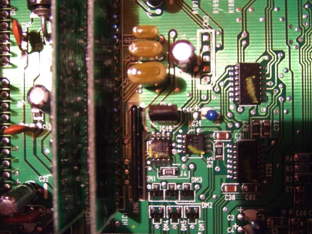

also the wiki says cut J4 on the front of a JDM ECU to enable full duplex datalogging. However there is a resistor in J4 with '000' on it. DO I remove this??
Pic below

As you can see, not all a/t ecu's come with a factory external rom.
There is no difference between the oki and st boards....the board type is printed under the "T3J-E" silk screen, I have only ever seen the last four digits ranging from 1500 to 1503 on jdm ecu's.
This is the only way of determining board differences/revisions.

J4 is a jumper, 000 means it has no resistance, remove it to enable full duplex comms.
If you are careful removing it, you can reuse it to jump J1.
