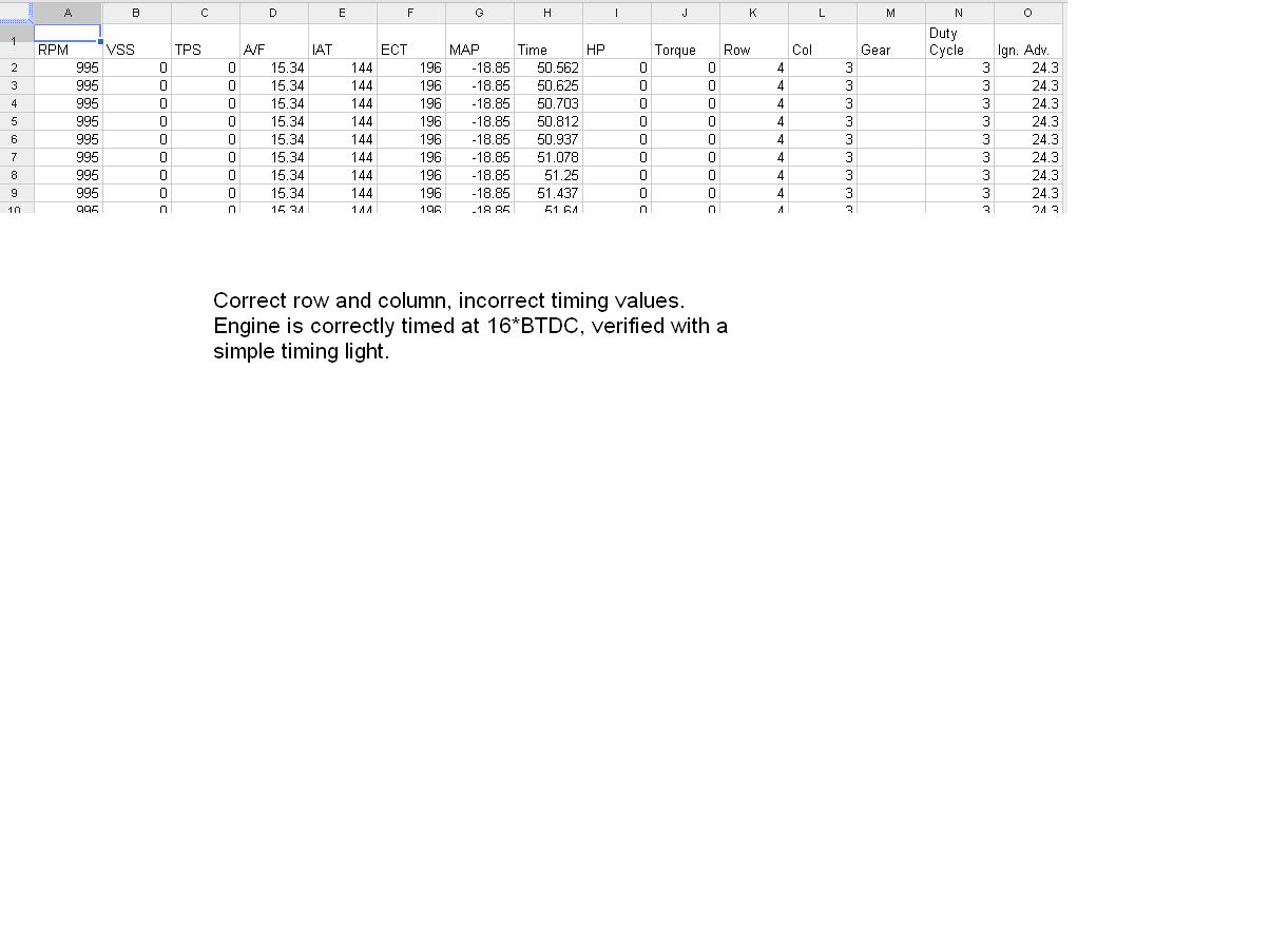

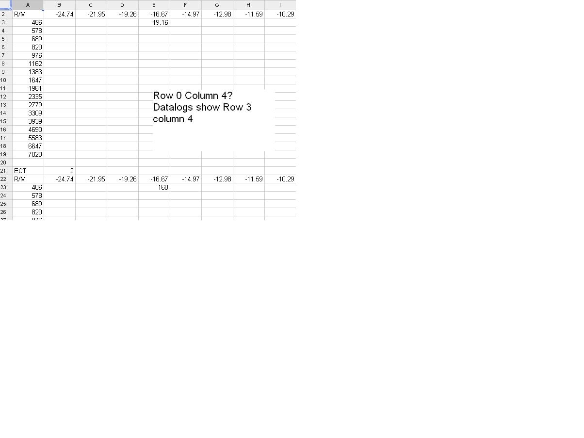

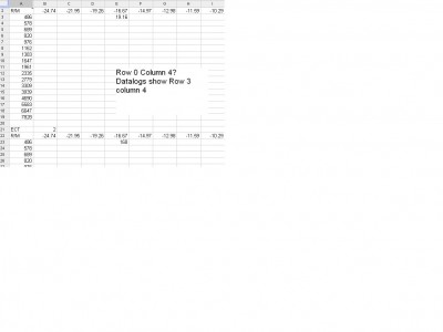

I have some screen shots of .csv's and map traces generated by ECUControl. Something screwy is going on.
This is a maptrace from a bin based on NG62. The engine idles darn well. However, notice the odd position of the maptrace. It's odd because as you'll see in the next screen cap, the map trace isn't in the correct position, and not reading correctly.
Look at the logged ignition advance. It's at 24.3 degrees. WTF? The timing is dead on at idle. The timing doesn't vary AT ALL when idling, which, is pretty effing awesome of TE. Also notice that the row and column are reading where it normally should, but the maptrace is definitely off.

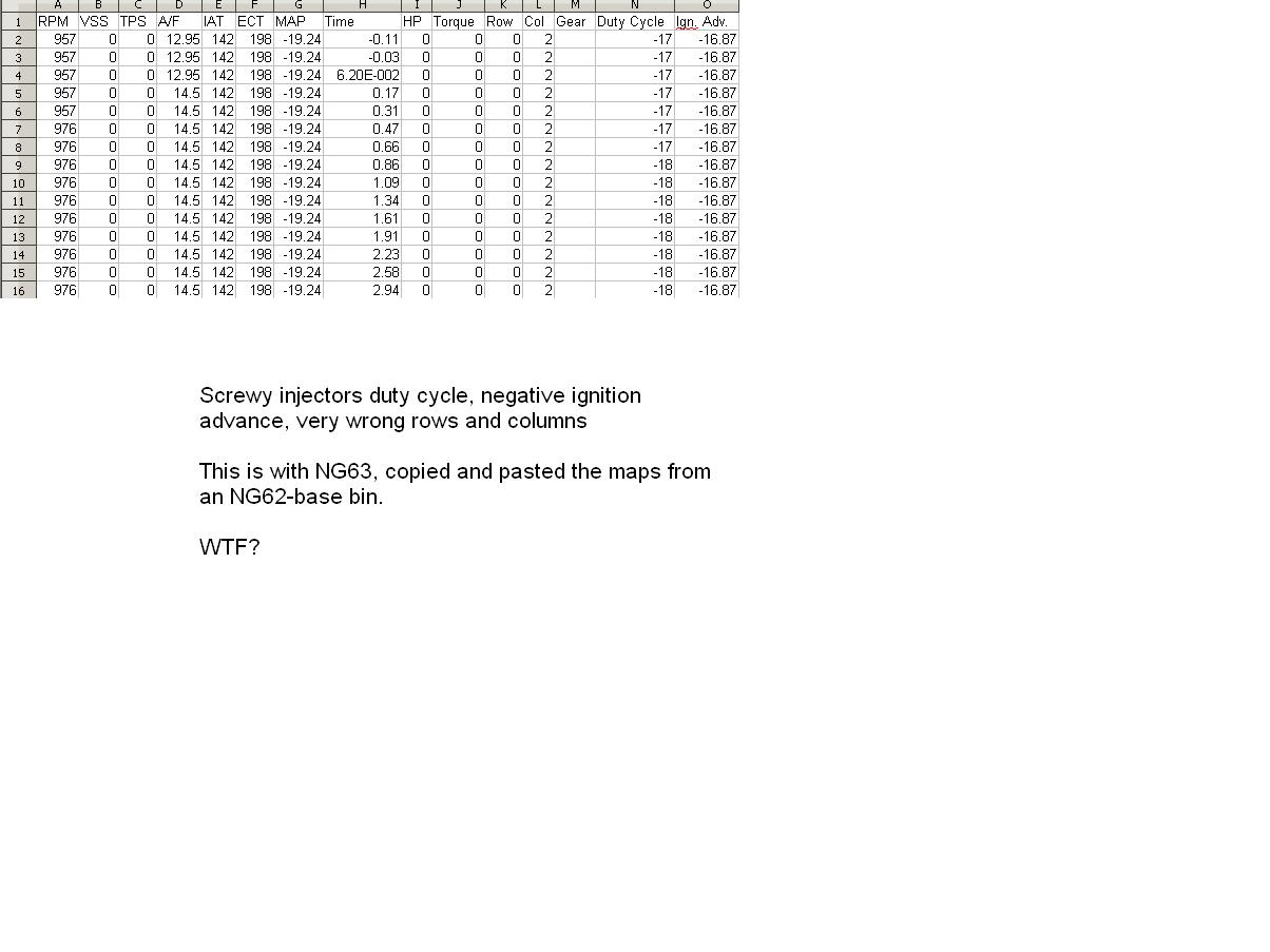

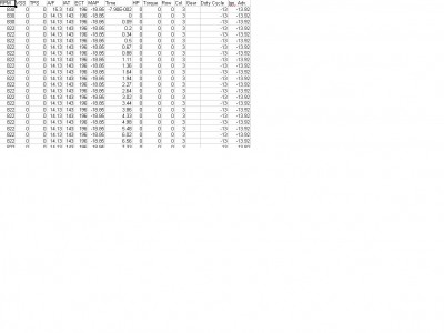

Ok, look at this. This is an NG63 (Final 2) bin with maps copied and pasted directly from the previous NG62 bin. Negative duty cycle and timing values? I know that's wrong because the engine still idles dead on 16*BTDC.
What's going on?
FYI, this is not my car. I am helping tune a car on the West coast. This is kind of annoying. =/
File comment: Now here's where things get screwy. This is a bin based on NG63 (Final 2) with the maps copied and pasted from the previous NG62 bin. Look at the crazy numbers!

File comment: Same NG62 based bin, timing is perfect at 16*BTDC

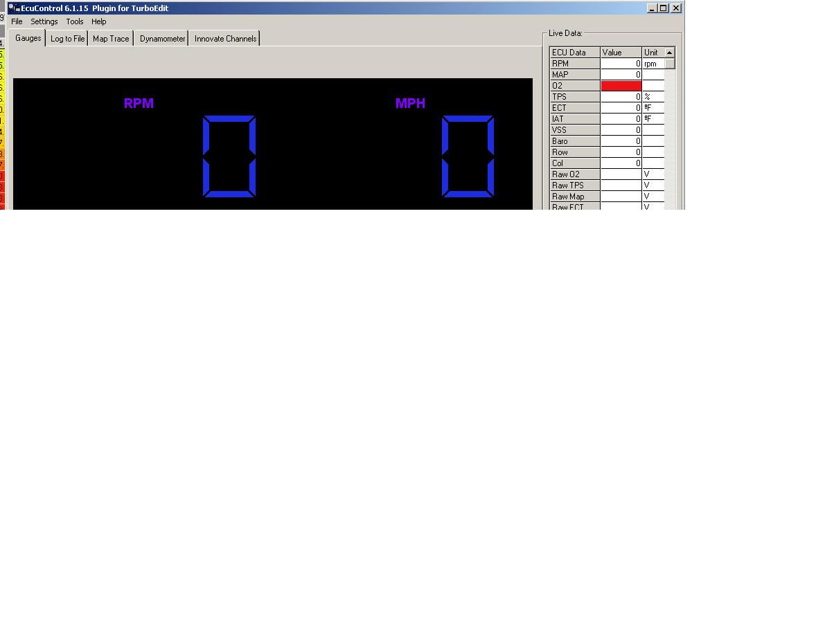

Well, WTF:
I just re-re-re downloaded this file:
download/file.php?id=7702
Uninstalled all previous versions of ECU control, standalone and plugin, re-registered the plug in .dll in TE 3.2.10 and then I get version .15 showing up when I install it.
Help?

1. go to TE>plugin manager and uninstall the 3.1.15 dll file from TE
2. download 6.1.17, then go to TE>plugin manager and install 3.1.17 dll file to TE
3. start the plugin and you should get 6.1.17
if you dont uninstall from the plugin manager, it will still pull from the last know file location.
as far as the wrong row values, anything older than 6.1.17 will log the drive gear in the row address for ng63 and should be correct for any other ng6x code. so as long as you are sitting still, the row will not change from 0. as far as the wrong pulsewidth and timing values, im not exactly sure. it seems to work correctly on my laptop...but will double check it.
archive or delete anything older than 6.1.17, as that should work correctly when switching from ng6x to ng63. in the older code the row is calculated by dividing the rpm value by 16 and saved in a certain address...in ng63 the gear value is saved in that address and the datalogger takes the rpm value and divides it by 16 instead.

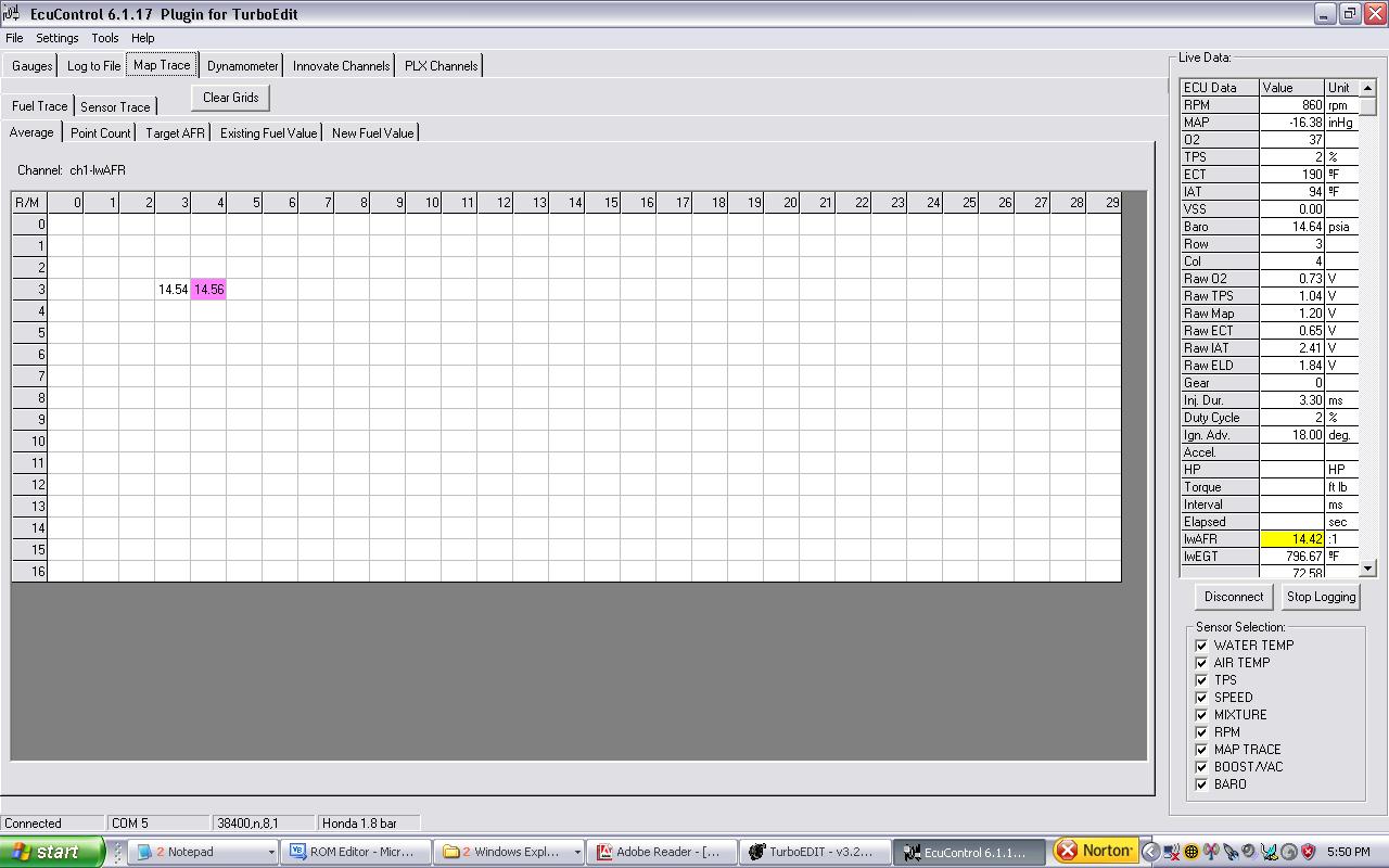

just to be sure, your using an ng63_final(2) rom and ecucontrol 6.1.17? the log to file should say pulsewidth instead of duty cycle...make sure hes still not using 6.1.15.
currently no way to change the log to file stuff...but you have a point about the eld. i will add all the other sensor values and get you another version to try...i believe i still have your email.
attached is a screenshot i just took and a log to file, everything looks good on my end. i will check this out more tomorrow. :?

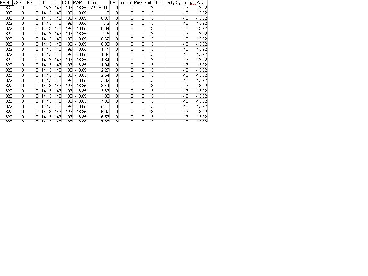

Ugh, this gets more complicated. I viewed your test log (thank you by the way!) and it is waaaaaaaaaaaay different than what he is sending me.
His datalogs are still showing the old headers, but 6.1.17 shows up at the top of his window? The other odd thing is his maptrace shows correctly, AND he doesn't get any negative values showing in his live view.
Is there any reason why the log would be getting screwed up?

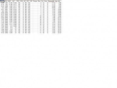

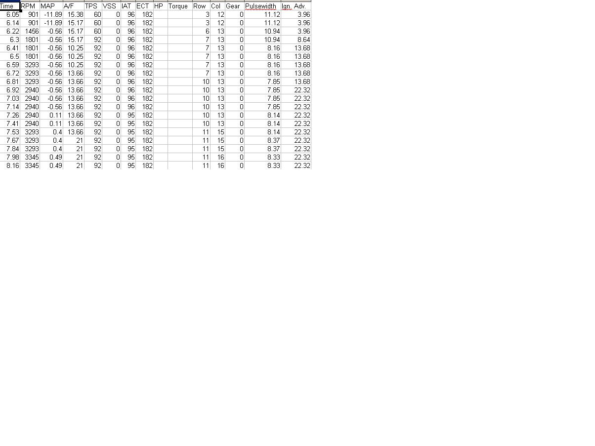

To compare-
The dudes log:
fastcrxsi90's log:
This is funky. =(
