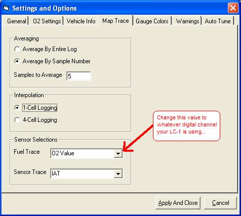

i use a Lc1 WB and log trough Ecucontroll inovatechanel.
the AFR gauge in ec show the right numbers, but i i go to fuel value chanel average/point count it only shows numbers like 49-150 etc.
Target AFR Map is the one wich comes with TE (just for testing)
The New Feul Value Map shows great numbers like >50 too.
sombody can explain that please ?
1 byte numbers wich where multiplie with the fuel multiplier ?

go into options and set the correct logworks channel for the fuel maptrace...sounds like you have it set to the nb02 non-voltage values.
the new fuel value math is basically target afr / actual afr....so if you target 14 and the gauge says 120 then your fuel value will go up by a multiplier of 9.2 ---> 5.25ms turns into 48.3ms (which isnt possible anyways!).
make sense?

these are my options
the right chanel, chanel 1 (named by me afr] i set.
this should be right ?
fuel trace looks like this
shouldn´t there be the afr numbers ?

go to the map trace tab and change the fuel trace channel to the innovate one...you have it set to the nbo2 "lightshow" value...
let me know if that works...

DAMN !!!!!
i want to kick my ass :lol:
yes thats work.
thanks for the easy solution. :mrgreen:
