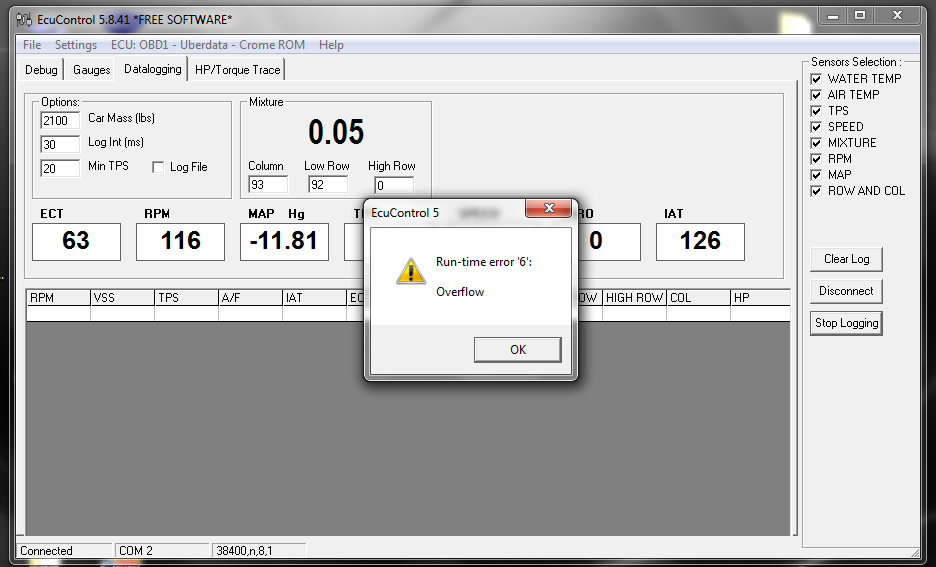

hi guys,
i am trying to datalog using ecucontrol 5.8.41 and getting error '6'
the ecu is a JDM P30 connected using nokia cable with J4 removed. i've added Quick datalogger +RTP in crome v1.5.3 to the chip
com port is setup correctly in device manager and ecucontrol.
help pls.. :|
PostPosted: Mon Jun 14, 2010 3:49 pm
Joined: Mon Nov 09, 2009 2:41 pm
Posts: 479
You have a connection problem. Check the direction of your DL header, the functionality of your hulog, and set a noticeable launch control limit & test to make sure you're actually running the chip.
