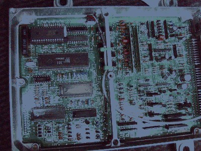

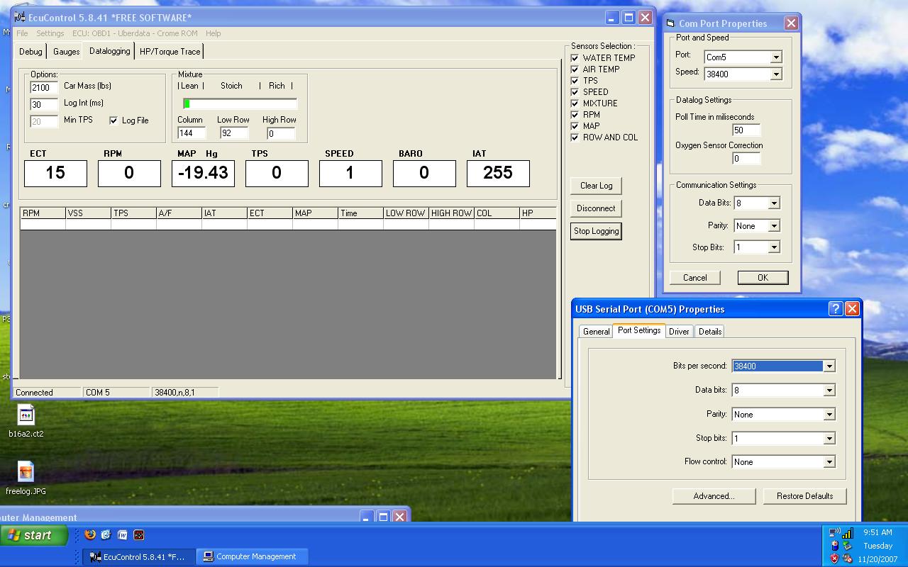

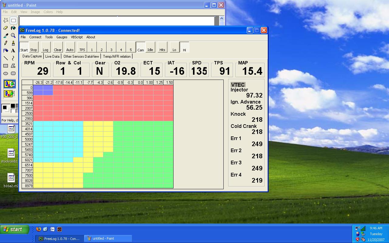

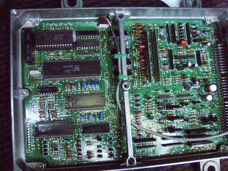

first of all I have been running an OBDII GSR ecu for the longest with my b16a2 swap in my EK.. I picked up a chipping kit and a burn1 from Xenocron (AWSOME TO DO BUSINESS WITH BTW) chipped and converted a p06 and put the right rom for my motor in it and i was like WOW.. night and day. I was so use to driving it with the wrong ecu (2 years).. anyways I also purchased xeno's datalogging cable and cannot seem to get it working right.. ecucontrol connects and see's everything and does log.. but the only thing that seems to be right it the vac/bst.. everything else is way off.. unless the VSS normally reads around 130 mph while sitting still =P Im using crome 1.4.8 beta to create and burn my bins... I use the JDM p30 base and import the tables from the P30G since i am running a B16a2.. remove checksum... p30 option byte hack.. quickdatalogger + RTP.. burn chip n go.. car runs like a dream compared to before but dataloging not right.. I need to get it working in the next week before I put the turbo setup on. im attaching the bin I have made maybe check it out to see if it is the problem.. J12 HAS BEEN CUT

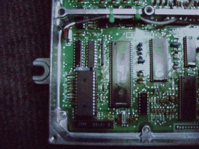

I did notice something looking at pictures R52 located just above the EEPROM has a resistor in the pictures I have looked at but the p06 I converted does not.. what is the function of that location?
I have also attached two print screens from both ECUControl and FreeLog remember both are at idle sitting still. also there isnt anything on the laptop I am using except XP, office, Crome, and datalogging software. its a P4 so the laptop is not too old.
File comment: Snapshot of the whole thing
File comment: EEPROM area.. notice R52.. nothing there..

Sorry I cant be any help but I was also wondering what R52 is for, I have 2 P28's sitting in front of me both without R52, what is it for?

i have the same setup pretty much and same problems all works but the data is all wrong can anyone help at all sure i ant the only person stuck like this.
