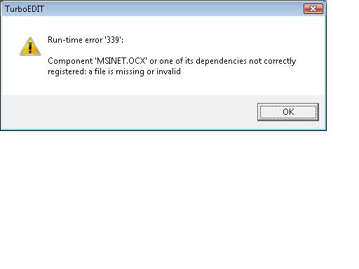

i get an error message when i try to run TE 3.1.10 when i run TE version 3.1.2 its fine i have the same error with every version after 3.1.2

ownload the resource files, http://forum.pgmfi.org/viewtopic.php?f=60&t=15233, or just msinet.ocx) and place the file in your system folder (most likely c:\windows\system32) then register it. to register the file, click start>run then type in regsvr32 c:\windows\system32\msinet.ocx and press ok.
this will vary depending on your version of windows and where your system folder is located...that should fix the problem.
you can also take msinet.ocx and place it in the same folder as your turboedit.exe file...9/10 that will work also.

i found a much easier way rather than fight for TE to be on my vista based desktop so i can learn, i got a free laptop from a neighbour with xp i fixed the power input port and TE and Ecucontrol work awesome nut thanks for the help
