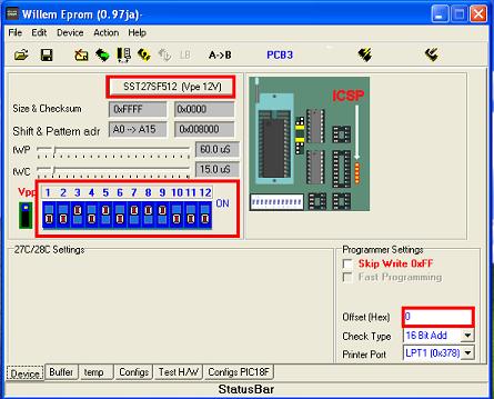

Here is a quick run thru on how to erase and program your SST 27SF512 with the Willem Programmer this should also work with AT29C512 with some minor changes. This is just the basics but will get you going. Pics are worth a million words in my case so there listed below (Hopefully)
1. you need to have the programmer hooked up to you PC and the drivers loaded. If you've made it this far your on the right track.

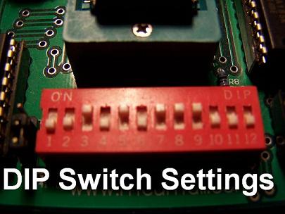

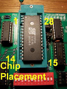

2. Set your DIP switch and insert your chip (SST27SF512) make sure the chip pin 14 & 15 are in the 2 bottom slots with the middle divit towards the lever.

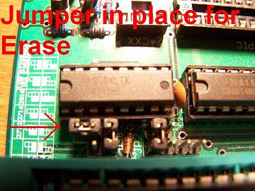

3. Click the erase icon (has the rom with a pencil eraser) If it is unable to erase make sure you have the jumper set up as shown below.
4. Load your bin your ready to program.

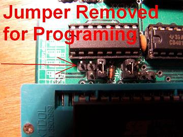

5. Remove the jumper (shown below)

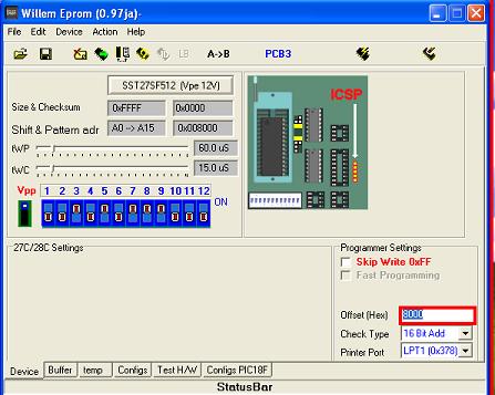

6. Goto the bottom Right of the Willem box and you will see Offset(Hex) and will be defaulted to 0. Change this to 8000.
7. Click on the program icon which is the complete rom picture. It will bring a pop up which will ask if want to use this off set, click yes.
8. It will program and verify. If both show 100% your good to go. Replace the little jumper you removed (so you don't lose it)
9. Put the Rom into your ECU
10. Turn on ignition and wait for the main relay to click off, CEL should turn off. If this is the case you have programmed it correctly.
